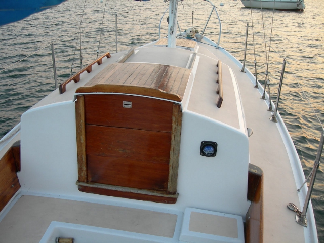

Maybe consider a stock hatch from Chris and add a wood veneer?
Attachment 9128
Mike,
Exactly what I was hoping to do. Nice non-skid. I used Awlgrip, Grand Banks Beige, with their additive texture and it looks like your same color.
Chip, C-124
Hey Mike,
Are those slats just attached with epoxy or is there mechanical attachment? I am wondering about children walking on them and if they might be prone to cracking the epoxy if that happened. (insert "Not A Step" plate atop!) Looks very nautical. Did you bow the transverse pieces before attaching?
KW
Thanks Chip. We used a mix of Interlux Interdeck white and beige for the non-skid. I was really pleased with how it came out, although I do find it a bit difficult to clean. Next time I will use the KiwiGrip nonskid. The boat I sailed last summer was done with this and I loved it. Here's the non-skid piece of my project on Tim Lackey's website: http://www.lackeysailing.com/seaglass/51707.htm
Hey Kyle, we've gone over this before somewhere here, and I'd love to take credit for the hatches as with some other details on my boat, but most of the neat details and woodwork was done a couple of POs ago. There are no mechanical fasteners on the hatches, they are glued on - I would guess epoxy. The patterns were done with individual strips, then the gaps filled. I'd think that makes bending them easier. My hatches have the rubber caulking between the strips which doesn't take varnish very well. I've read other applications that fill the gaps with epoxy colored with graphite.
