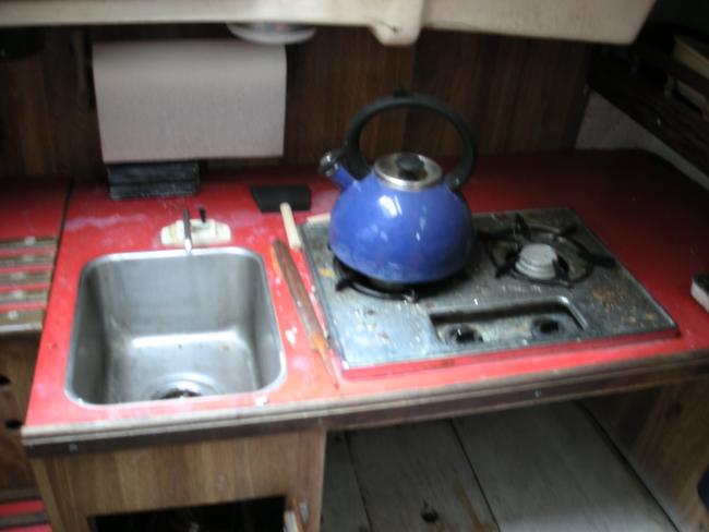

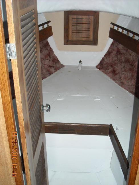

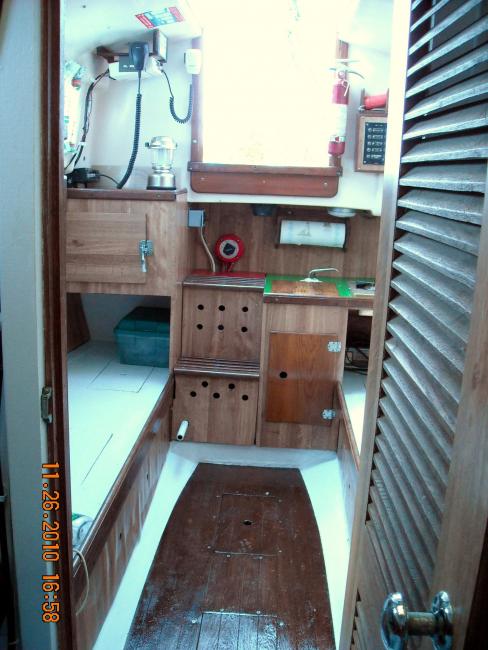

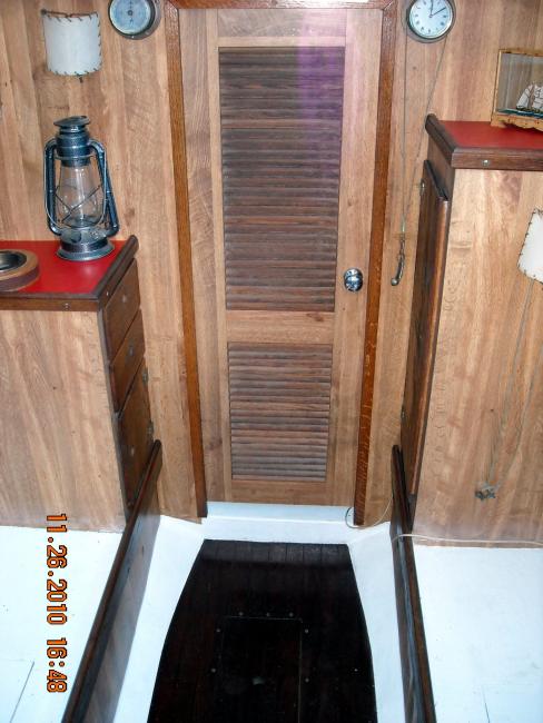

Hi. As promised here are some pics. of my girl's interior make-over. I wish I had taken more before shot's but I was so excited and dove right in not thinking much of record. But if you seen my previous post these should convey the dramatic transformation. First I removed everything and went through with my hammer, telescope mirror and to my astonishment this girl was sound all but a few easily patch-able spots! I am a painter and I painted all the inside with exception to the hull itself with 100% acrylic exterior paint. Attachment 8005Attachment 8006Attachment 8007 I redone the stove counter top, which was red and badly stained and stripped and sanded the stove top top and bottom. The counter top I sanded and sprayed with enamel emerald green and coated it with three coats of polyurethane.

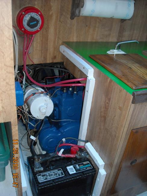

How does my engine look? I worked hard cleaning and stripping. You know how hard it is diving into the starboard and port compartments from the cockpit. A good thing I have a certification in Auto tech. as I pulled all it exterior parts off and cleaned them and checked them. This engine runs like a top! Fires up right away and runs cool as cucumber! I did have trouble at first with the float sticking but I was able to re-polish the float needle solving that problem. Definitely don't need any gas in the bilge! In the last picture I have re-routed those wires, old antenna and depth sounder, speaking of which my next post I want to show how I mounted my Depth sounder fish finder so you can swing it in and out of the cabin without dismantling it. I think you will like the curtains and cushions I cleaned/replaced as well. Hey those 1960 England made barometer and clock still work! I love It!

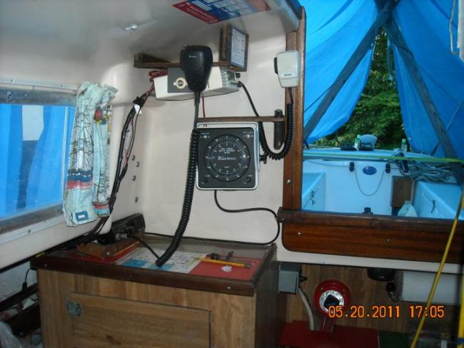

Last Spring I installed a new depth sounder/fish finder. I wanted to share the idea that had evolved in the installation. I used a 3/4 " thick piece of oak. 5 1/2 " L and 3 1/2" W. I drilled two holes on one end and attached it to the outer edge of my companionway frame opening. I drilled another 7/16" hole through the width on the other end for a hinge pin type function. I then added another piece of oak strip for an extension to mount the monitor on. This is what I came up with.:D Attachment 8013Attachment 8014 I will be adding another thin piece of oak (an angular brace) under the extension piece holding the monitor for support and stability.

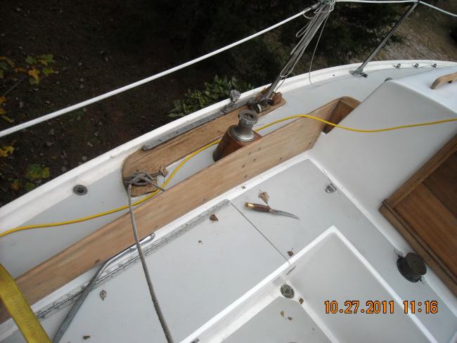

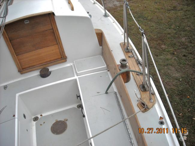

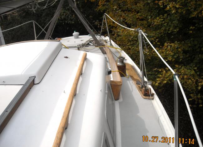

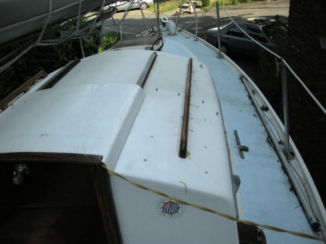

This summer I have been re- finishing the teak and ant-skid on Anne Bonny. The teak was in pretty good shape. I was a little peeved when I found someone had stained it though. Why someone would go dark on such lovely grain I don't know. I didn't want to strip it with chemicals because this was very old teak and I wanted to preserve what oils and integrity was left. So, pains- takings I scraped and sanded every bit. There are a few small issues but overall I think it came out well. As far as the anti skid I will put another coat on in the Spring.
Attachment 8018Attachment 8019Attachment 8020Attachment 8021Attachment 8022

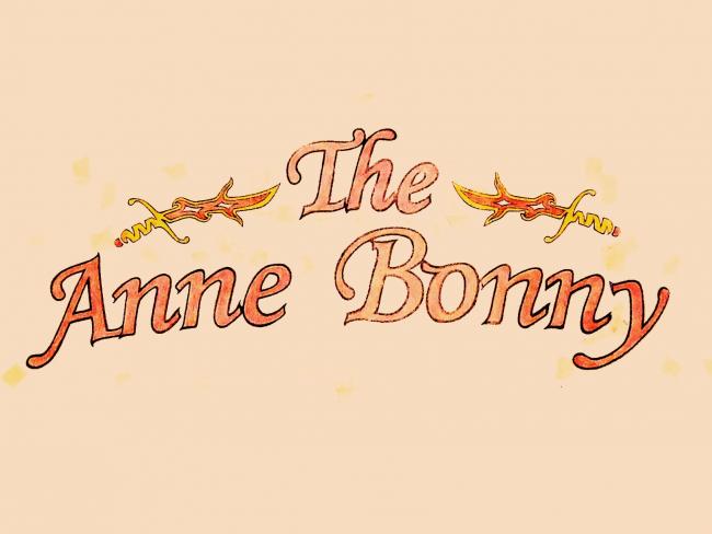

I did this myself..a little rough but I am an decent artist and will perfect it when I transfer it to Anne's transom. This is drawn in actual size, though you can't tell by this picture. It is colored pencil.

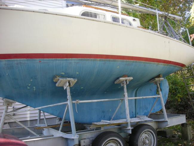

Well as winter closes in I have to look for new things to do. And one on the list and probably none better in taking on is removing the paint off the bottom. This because it requires hard labor for me( because of my approach) and it makes it much more easier to put more time in. No worry of a heat stroke! The anti-foul on Anne's bottom side is old and flaking. I am scraping for the reason that I can feel and see any discrepancies in her soundness. I am using a dull knife and 5 "n"one scraper so if there is a soft spot I want to know it. Besides..no pain no gain, great exercise. HeHe.. It comes off fairly easy in spots anyway. I will sand what I can't scrape off.
