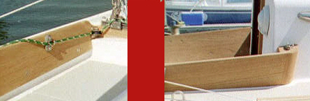

The photo below is of my boat, "Augustine." hull #330 with the Semco Teak Sealer Natural Shade on the teak
