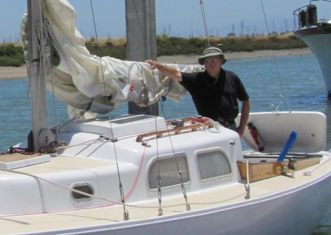

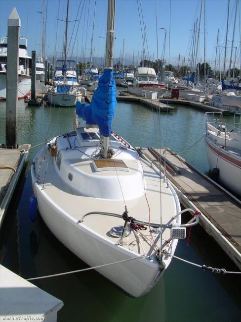

Ariel # 75, formerly named "Jubilee" and now renamed "Ad Astra."

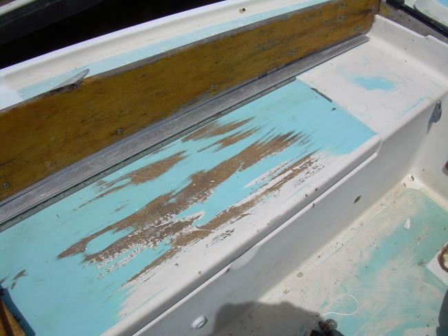

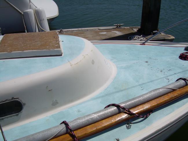

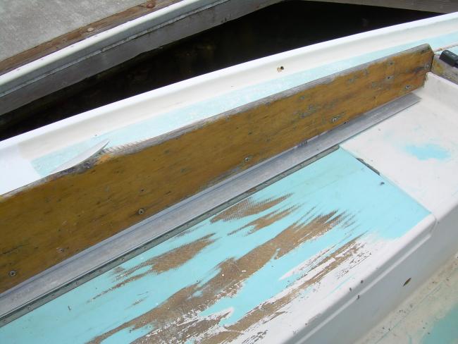

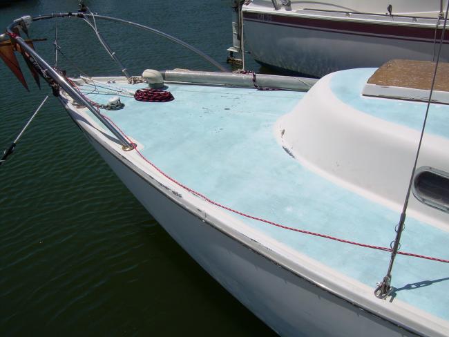

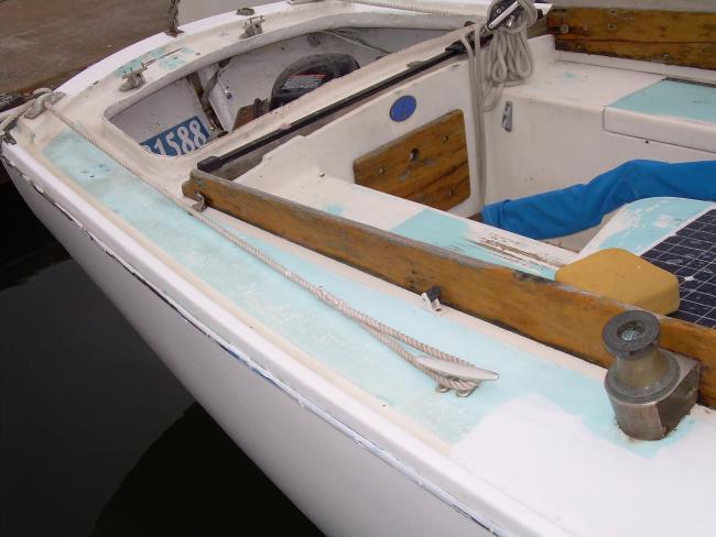

She had a very worn surface with chips, scratches, spider lines, and surfaces worn down to bare fiberglass. The molded-in anti-skid surface was worn smooth in areas of heavy use, and no longer safe.
Inboard jib tracks had been installed and, judging by the multiple perforations into the cabin headliner, reinstalled several times. The through holes had contributed to leaks. I removed these tracks prior to painting.
I chose a one part polyurethane finish, on the advice of Interlux. Epoxy based paints are tougher, but less flexible and difficult to repair. I used Interlux white Pre-Kote (4279), Brightside white (Y4359) on the hull and cabin top. I retained the original lines between smooth surface and anti-skid, and used sand beige (YJG009) for the anti-skid areas. Once fully cured (which took weeks in the cold wet weather this spring), the paints are very tough.

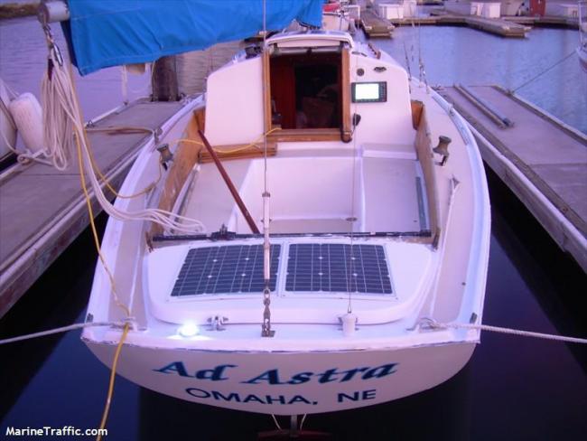

I've installed 100 watts of solar panels. The panels are very thin - only 3/16 inches thick, have a non-skid walkable surface, and perform as specified. They are made by Aurinco.

I replaced every incandescent with LEDs, which allows me to turn on every light on the boat (nav, bow, steaming, and cabin lights) while drawing less than one amp. I also installed 200 amp hours of cycling-type batteries (130 pounds added to the ballast) and a Schottky diode pair rated at 160 amps for load balancing.

The last photo is a view with some masking tape still in place.
