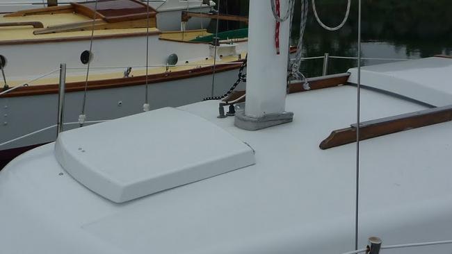

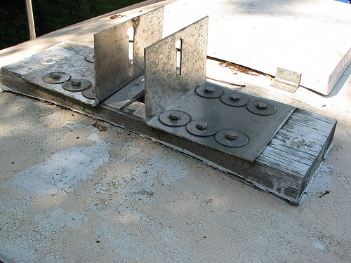

Not exactly what your talking about ebb, but these two photos cover the extremes!!!

No corrosion mast step
Carl,
Golly, hesitate to call that bracket in the second photo anything more than a mast utensil.
Hinged mast devices are often called tabernacles for some reason, some reason beyond practicality, maybe because it's a receptical for a precious object.
Triton Mike's halyard turning plate is bent up with holes on all four sides.
If every line is led aft to the cockpit you can't have too many blocks at the mast base.
Interesting to see the base you show seems to be leaning aft.
