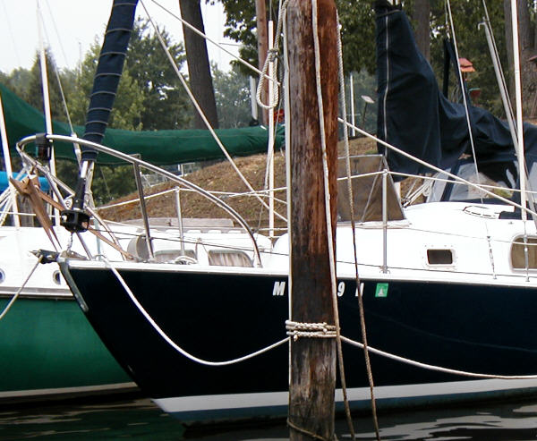

I replaced Sirocco`s life lines stanchions and bases 11 years ago.They are very solid,I would trust them with my life.They have over sized aluminum backing plates and are mounted in soilid glass,if you dont trust your life lines I would just take them off(false security).I have them attached to the bow pulpit at the perfect height for my roller fuller,my 165 is not a deck sweeper.Roller furled sails are cut different than hanked sails,the sails never touch the lines.The lower line was added to help keep the dog on board.
