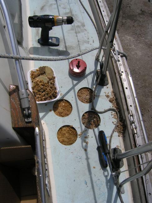

I've decided to try a unconventional way of fixing some wet spots in my deck. I wanted to avoid weakening my deck too much, so I thought instead of totally detaching the top FG layer, I'd drill out some big holes and poke the wood out from there:
Attachment 6592Attachment 6593

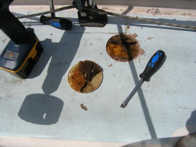

Indeed the balsa was totally wet and had mostly detached from the fiberglass. My next steps will be to remove the wood below the rims of the holes, maybe with a wire brush attachment for my Dremel or drill, dry it some more, and then fill it all with epoxy. Maybe try to thread some pieces of FG in there, too. I'd cap it with the round deck pieces I saved, fill the gaps, and fair it.
What do you think?

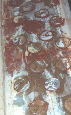

I recall a recore job being done by cutting discs in the top skin. The author numbered all the holes and discs. If I recall correctly, Good Old Boat featured the article in one of their issues. I bet if you contacted Karen Larson she could give you the issue number.

It appears in the photos that the core is bad in an area where there is no deck hardware. This would lead me to think that this entire deck area is bad. If I were to make the type of repair your doing just to get back to sailing I would use balsa to go back in your holes and not all epoxy. My reason would be that this area will have to repaired in the future and I would not want to grind all that epoxy out at a later date. The balsa grinds away a lot quicker and is a quicker and cheaper filler material. Just a thought.
I remember that GOB article. It was done with a much smaller hole saw though.

You may also want to take a normal drill bit and drill exploratory holes out from a bad area until you get to good balsa just to "map out" the areas you'll need to address and to get an idea of how extensive a repair you have on your hands. It would also give you an idea of where the water is getting in. It goes without saying to be sure not to drill all the way through the inner skin...

I agree that the holesaw/disk method will preserve the camber and integrity of the deck. But I also agree with bill that if you have extensive rot cutting out panels of deck will prove easier. However that depends on your inner skin of the composite. If it is as thin as is is on LittleGull you may have a problem keeping integrity when you work on it scraping off the rotten balsa.

HOWEVER, it is evident from the photos that to get good results you will have to remove all fittings from the deck. I agree with numbering and mapping each and every disk removed. While the making of the deck unit by Pearson required some precision in the construct of the composite/sandwich there could be anomolies that would not allow interchanging the disks, even if they are all cut with the same holesaw.

1. The wet area is limited to the area where I put those four holes and a few inches further. There's another soft area on the foredeck, but I won't tackle it yet, it's not really that bad. If I had to remove more of the deck I'd indeed use the 'traditional' method of cutting the upper skin off.
2. The area I drilled open is right at the entrance gate in my lifelines. People keep stepping on there, and I had some mold just below there in cracks in the inner liner, clearly fed by this moisture.
3. You can see that the PO had attempted a repair of this area many years ago. The deck under the stanchion bases is filled in with epoxy it seems. The bases are rock solid. However, you can see a rectangular crack where the repair was done. This is in my opinion the place where water seeped in. There is no other source I can think of. I think the repairer did not chamfer this area and so the crack developed.
4. The balsa core is indeed apparently just 3/8 in thick. It appears, from looking at the disks, uniformly thick, so the disks are probably interchangeable if I cannot figure out anymore which is which. I hope.
