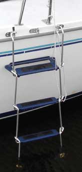

new design boarding ladder.
New to me. A unique and different ladder that might be strong enough (in 4 or 5 or even 6 step versions) to withstand loads put on it when boarding from the water.
If you go overboard with clothes on your movements are restricted.
Here is a ladder that you can get customized to the length you think you need
for the steps to be accessible for you to climb out of the drink.
I'm thinking three steps IN the water minimum.
Any boarding ladder has to be thought of FIRST as a life saving device.
The word 'collapsible' is in the description -
but the solid s.s. rod rungs are LINKED and slide to extend or compact.
The steps seems wide enough for bare feet, some bare feet.
And as designed wide enough for BOTH feet to be on one step.
When extended the ladder becomes surprisingly stiff, yet still has give to it.
The top step and other related rod pieces of the model I saw have been dipped in a thick polyurethane.
It seems to pull up from full extension quite easily with a light cord.
The model I saw was attached to a two legged life-line gate stanchion -
since the concept, imco correct: which is to mount the ladder off the side of the boat rather than the stern.
But I think something more substantial like a three or four legged anchor system would be better, especially if it gets regular use.
Each ladder is customed to your boat.
You send them certain simple measurements with your order - like the stand-off from the hull - how tall the unit is mounted - number of steps.
Imco this ladder will take abuse that telescoping and tube ladders can't.
In a comparison test with other tube and rope boarding ladders,
THIS, imco, would win hands UP!
Around $300? A lot. But it is made with 316. And it's made in the US. Hopefully made with pedigreed alloy.
There are three distinct models: dock, dinghy and boat.
I'm talking about the boat model.
It's worthy of a picture here!
It looks like rugged cruising gear that will last for decades.
