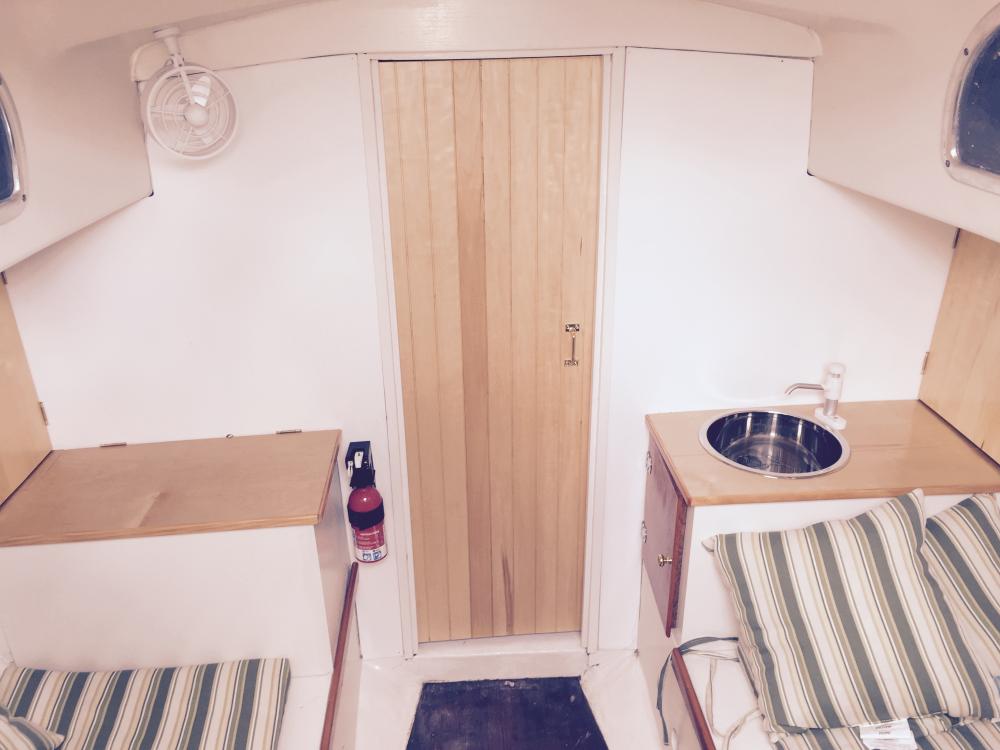

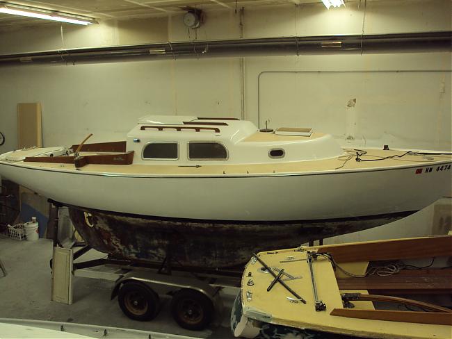

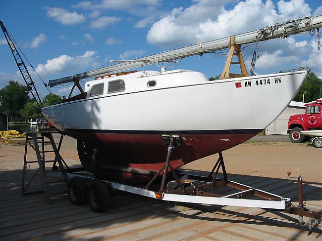

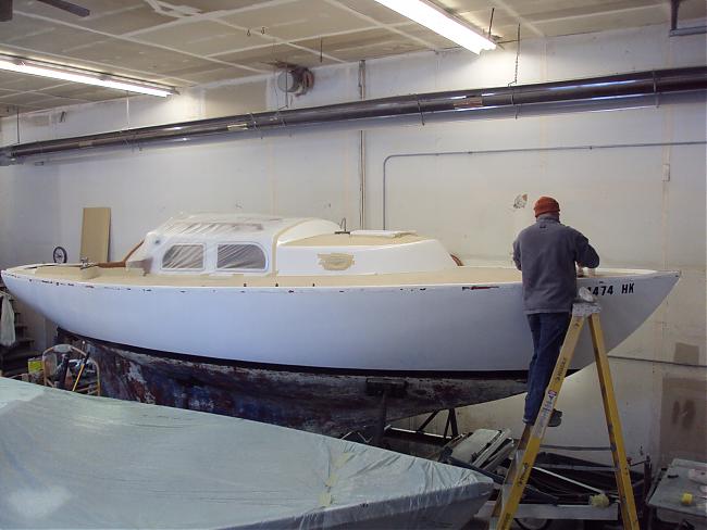

She was damaged by a marina and their insurance totaled her. The owners wanted to keep her out of the landfill so they bought her back from the insurance company. I ended up picking her up from them. We churched her up enough to get her back in the water last summer and let customers and friends take her out. One of our customers took a shine to her and bought her last fall. We have been taking care of a few items over the winter and the N.O. has plans for her interior.

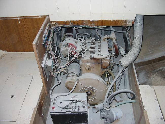

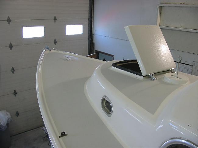

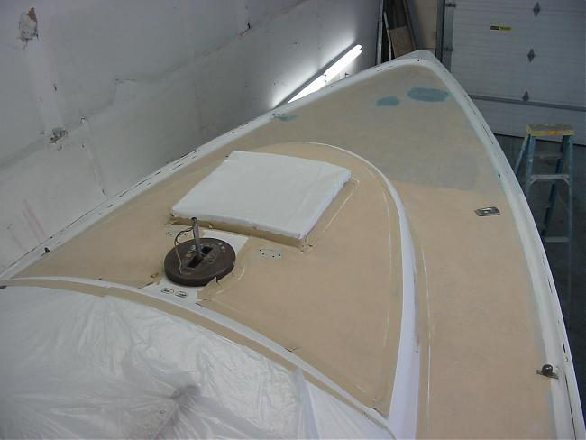

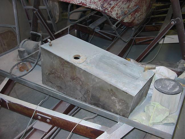

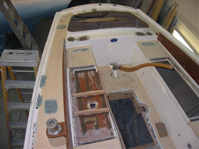

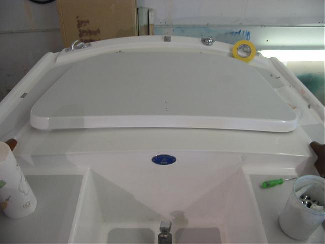

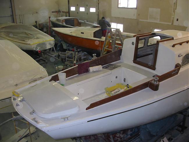

235 is in pretty good shape, a few soft spots but over all the decks are quite sound. We removed some old hardware, filled some holes, recored the soft spots, painted the toe rails and applied new nonskid. The strong back had a bit of a sag to it and had a plate bolted on over the door to stiffen her up. We still need to cut out and replace the strong back. 235 is equipped with an Atomic 4. It ran pretty well after cleaning out the carb and giving her clean gas. We had to cut out the cockpit floor to get the old tank out. the pick up tube was rotted out so bad it would only deliver fuel from the top 1/3 of the tank. Last fall we fit it out with a 3 gallon outboard tank in the aft lazerette. The fwd/rev shifted was about 2.5' long and you would unscrew a deck plate on the cockpit floor and stick it in when you were under power. We have removed that setup and install a nice Morse single lever throttle/shifter.Attachment 6502
