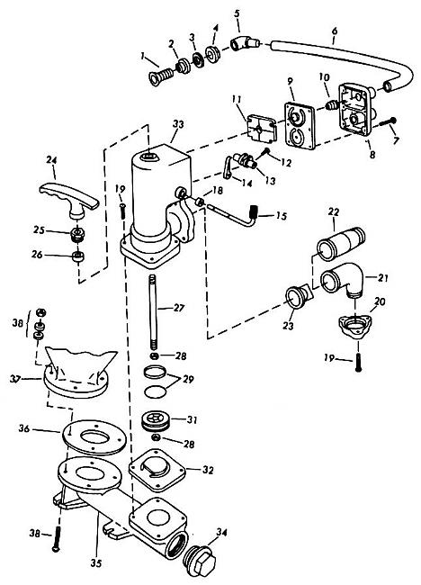

here is the link to the OEM parts list:
http://www.wilcoxcrittenden.com/repl...parts.asp?bid=
the attached drawing is the pump assembly for the headmate model (installed on A-231)
