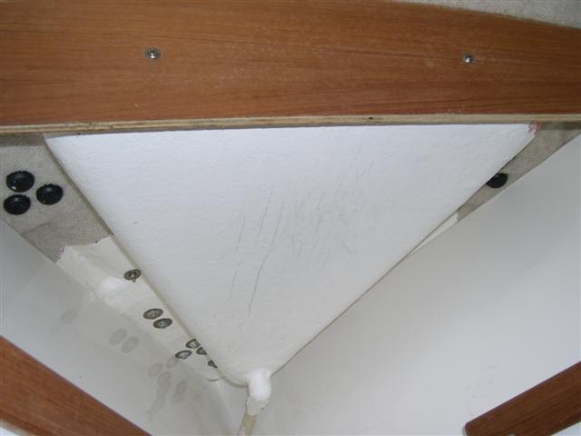

What I was thinking is that if I removed the existing chain locker bulkhead and on the top half built an enclosed chain locker similar to this P-18 I own and glass in a drain from it to the keel where it currently drains I could add perhaps a foot to the v-berth length and make it much more comfortable to sleep in. I would have to add an access port to the aft end of the chain locker but I can't see why it would not work.

Alternatively, you could drain it directly overboard like Frank did on his Ariel...
(And, direct from my "ideas" folder...)
Frank's mod doesn't add space to the v-berth, but does make more storage space available and drains the water overboard...
http://www.pearsonariel.org/discussi...0&postcount=36
http://www.pearsonariel.org/discussi...0&postcount=37

Mike do you know how Frank drained the anchor locker overboard? My P-18 drains out right at the bow. You can see the PVC coming out of the bow in this picture.
Ditto with Frank's mod, although his is off to the side. I think there was a picture in his gallery thread somewhere.
