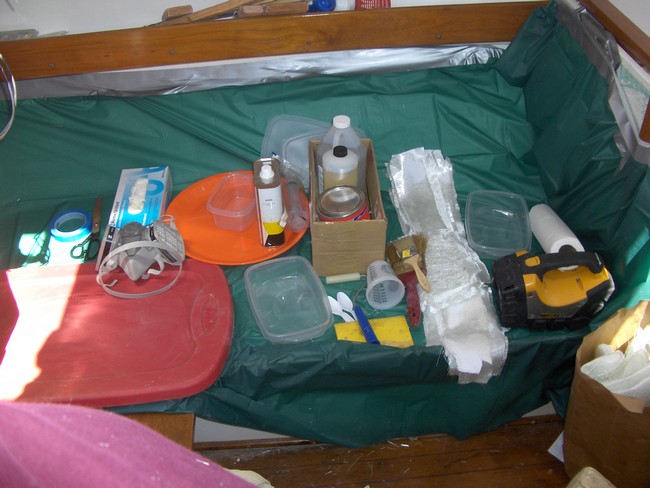

The picture below shows some of the implements I was using for a fiberglass job
The rectangular plastic containers were probably for holding acetone soaked rags, with the lid on so they don't dry out. I usually mix the epoxy in small round plastic food storage tubs.
Also not pictured is those tinfoil roasting pans or lids I sometimes use to wet out the fiberglass on.
There should be some white vinegar around
Even with a brush. roller and squeegee, most times I end up using my hands to mush things around

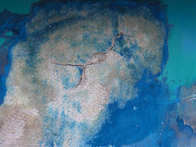

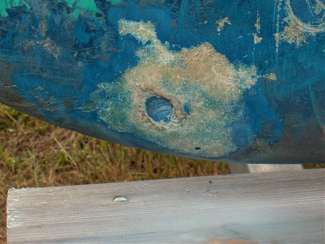

Enclosed are a couple of pictures of a keel repair I'm starting on. My question is , should I just cut back a couple of inches from the damage,"V" the hole out and start laying in the cloth for the repair, or should I make this a uniform shape and then lay the filler back in? I would think the smaller the "patch" the better!
I might add this is in the encapsulated ballast area. The ballast on this boat is totally sealed off from the bilge, which in this case was a very good thing since only enough water entered to fill the ballast area, had this area been open to the rest of the bilge it would have surely sunk the boat.
I've drilled a couple of holes to drain the water out and dry before starting repairs. I also plan to put a couple of gallons of 4 to 1 epoxy in to fill what I believe is a hollow area under the lead ballast.

It it were me, I would get an angle grinder and grind out the bad until I got to the good.
Basically, I would keep the cutting wheel broad to the cracks and grind out the cracks until there were no more cracks. The nice thing is that your repair (done correctly) is going to be as strong or stronger then the area you repair. I would get as much of the damage out, and not be too concerned with getting a geometric shape (circle, oval, whatever).
The grinder will tell you when you are done. Go slow, and take frequent breaks.
It will all be ok.

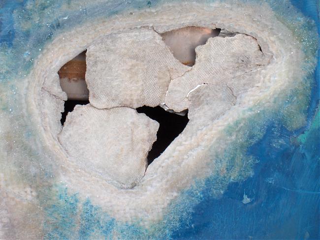

I attacked this with an angle grinder, then switched to a 4" cut off wheel on my drill, the grinder was just too dusty!
The few pieces left are just thin cloth pieces I left to have some type of backing for the first layer of cloth. I'm installing two layers of cloth at a time, I must be working slow cuz the epoxy is beginning to kick before I can do the third layer.
This damage is actually above the ballast area in the bilge as noticed when I saw the bottom of the water tank through the hole I cut. Rule must make a good pump to have kept up with this leak!:p
Carl, I think you should go wider with the dish.
Meaning shallower not deeper. Go further out from the hole. Like four/five inches. Can't tell the scale.
I think more repair cloth should be attached to more good hull.
The last wider pancakes are fewer in number so you want more area to attach them to.
I would use cloth rather than Xmatt.
And turn the weave of the cloth 45 degrees when you stack them. Random.
If you are going to stack more than the hull thickness and grind down to fair the patch with the hull, top fabrick layer should be Xmatt.
The pieces you have left as backing are probably thin enough not to detract from the final thickness of the repair. It looks like you have a hull like #338 which is not very heavy in thickness. 5/16" is what Little Gull has.
I think the repair will benefit with wider patches - even if there will be fewer layers of them. Try not to use any fairing compound to fill any depressions in the patch itself. Fill with cloth, grind flush, then fair with compound for a smooth surface.
This dish thing is to make a bowl, however flat a bowl it is. I don't believe a flat center with short rising sides to be a strong shape. It's OK to have a flat, but the sides need to be widened and stretched way out to get benefit from a graduated layer patch.
Put it on your future list to add cloth to the inside of the patch if the area ever gets exposed. This will lock the repair in place.

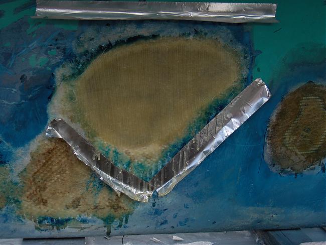

I manage to get on the repair today,
I ground off about two layers, excluding a couple of small high spots which I smoothed out the patch is now as true as the rest of the hull.
I then beveled the hull out about 2.5 inches all around the hole and then layed on a 12"x16" patch. After this was done I came in and turned the computer on:eek:!!!!
I'll need one more layer to bring the height up to match the hull. At this point I'll grind out about 2 more inches around the last layer and lay the final patch on. Smooth and quit, on the outside. Then I'll lay a 12x16 patch on the inside
The small hole at the bottom of the keel I'll use to pour epoxy into to fill the void beneath the ballast. On this hole I'll try the large patch first and work smaller from there. As Tim did on A 24
I'm using 1:1 epoxy from Fiberglass Coatings Inc. out of FL. This stuff is nonblushing , in this temperature has about a 25 minute working time.
