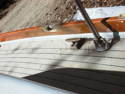

There are a couple of boats out there with their decks sheathed in Trex or a similar product. I've never seen nor heard of it being used for coamings. It sure would be nice to have a bunch of maintainence free brightwork wouldn't it?
If I recall correctly, Dr. Mark Parker put synthetic wood decks on his Triton All Ways. Take a spin over to the Triton MIR website and look under the gallery or in the maintainence page, I can't remember.
Here you go.
Are your coamings shot, or just in need of a bunch of work?
IMHO, I think it works in that application because there is plenty of real wood and other eye candy to ogle.
PS. I just love love LOVE those bulwarks with the inset chocks. How sweet is that?!?
thanks for your response. the pictures look great.
