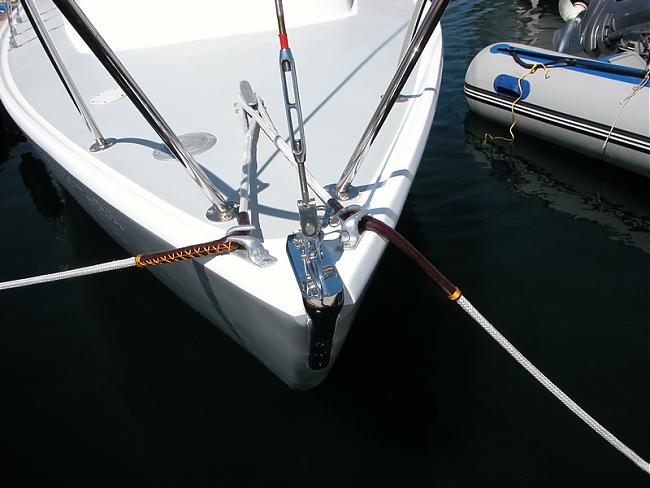

I've used a few strips of surplus leather pieces... I got about 20 strips for about $15. Fortunately - and purely by chance - they happen to fit perfectly - just a bit of overlap. I did not need to trim them further...
I punched the holes in and tied them up on all my dock lines. They've been on for about a year & a half and are holding up great. They do not seem to mind the salt water either which was an initial worry.
The picture shows me at a small (20') slip with very low docks and poorly positioned cleats. My current dock floats much higher with cleats that are better spaced.
My neigbors really like them as they have a salty look to them...
