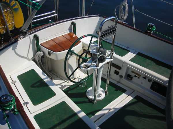

Where did you put it (the Compass)?
I've been searching around the threads here in the forum looking for other owners spot of choice for mounting a compass. Dream Weaver's was mounted on the centerline halfway up the bulkhead of the bridge deck. I'm not so sure I want a hole there anymore, and, I was planning on using the space (on the inside) for galley storage.
The instrument read-out heads will be in the hard dodger above the c-way so I don't really want to put it there among all the wires. The electical panel is on the starboard side and the sink and galley stove along with all the metal cookware will be on the port side. Just how much precaution is necessary in regards to the above?
How much of a difference does it make to mount it off of the centerline? Maybe add a shin high binacle just aft of the bridge deck?:eek:
