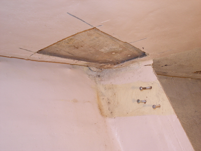

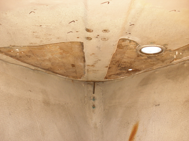

Hi Ariel/Commander folks. I purchased A 24 last fall and have started giving her some TLC. I have removed the damaged core from the inside. The areas around the stanchions were quite wet and mushy.

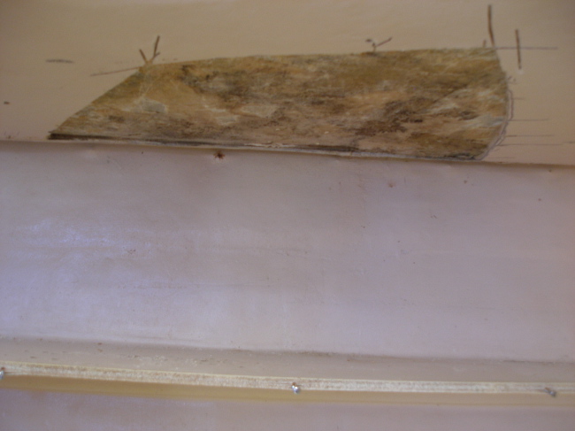

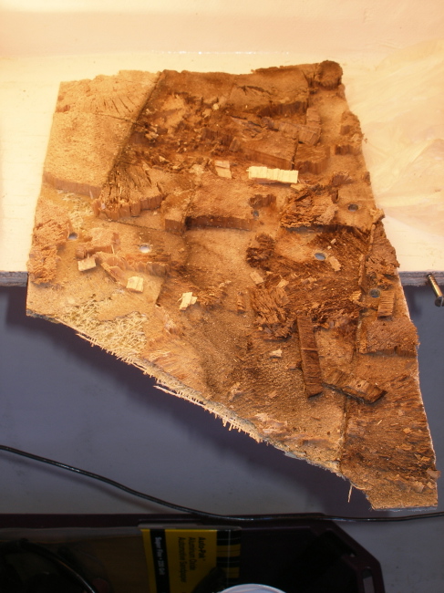

Below is what came out, and below that is the largest area removed (around 1 1 1/2 feet by 1 foot on port side).
