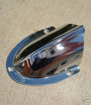

My hatch has vents similar to these over the holes. I believe that same seller is selling similar vent covers too. (Oops, sorry. Only looks like one, but they shouldn't be too hard to find.)
http://cgi.ebay.com/ebaymotors/STAIN...mZ250024157542
