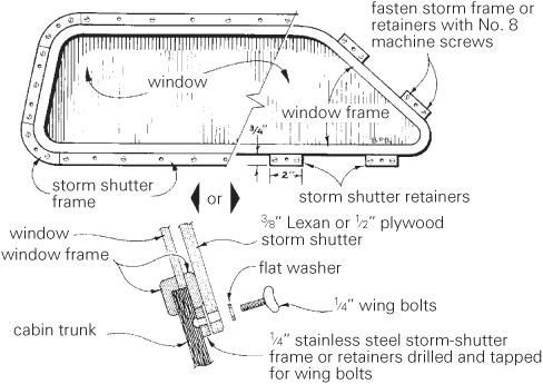

C'pete's find is a good-un. Sizes depicted could be our windows. I think that the frame fastenings should better match the lid fasteners in strength though - don't know that 8s would do the job, maybe 10s.
I guess a slab-on install like LG will have could have an extra surround added to seat the shutter - but the finished look would be massive. The cabinside look would be kindof of goggle-eyed. Even surrounding the standard Ariel frame with a shutter surround is an esthetic bomb.
However if studs could be permanently placed around the window and a shutter with an integral frame hung on the bolts - that might work - but again, there's a lot of screw-on prep for this option, for which there may not be enough time or opportunity. Small fastenings, cold hands. Whot else we got???

Quick and dirty storm shutters
OK, you forced me into it....
Since stormshutters are essentially for extreme situations, there is no need for them to be fancy (ie bolted on):
Each cabin side inside would have:
One piece of plastic or plywood to cover each window and a horizontal bar down the MIDDLE holding both shutters over the windows. The bar could be sprung in over three 'L' brackets that are permanently in place. At the ends and the middle. NO WING NUTS! The brackets might find other uses when the bar is not in place. Have to have some kind of keeper or register for the shutter pieces so that they wouldn't shift once the bar was put on. I see the shutter pieces and the bar as separate pieces for ease of storage.
