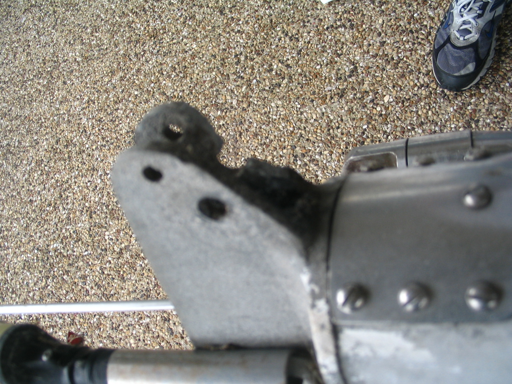

Well, after sailing C-229 for 2 years we finally broke down and got a spinnaker. After reading about how to rig the spinnaker halyard, I purchased a bale from Rig-rite. We finally got around to taking the mast down this morning and discovered that the masthead was broken where the front stay is attached.
Well, there is supposed to be a picture there but I can't seem to figure out how to insert one. I need help on that.
But, to make a long story short, I need a new masthead.
Any idea where I can find one? Do they make new ones? Will I need a 2nd mortgage to pay for it? Any help is very appreciated and if you can tell me how to insert a picture I would be happy to do it.Attachment 4271
Did I do it? Is there a picture there? WooHoo! I did it! Forget the picture help. Now I just the bad news about a replacement masthead.

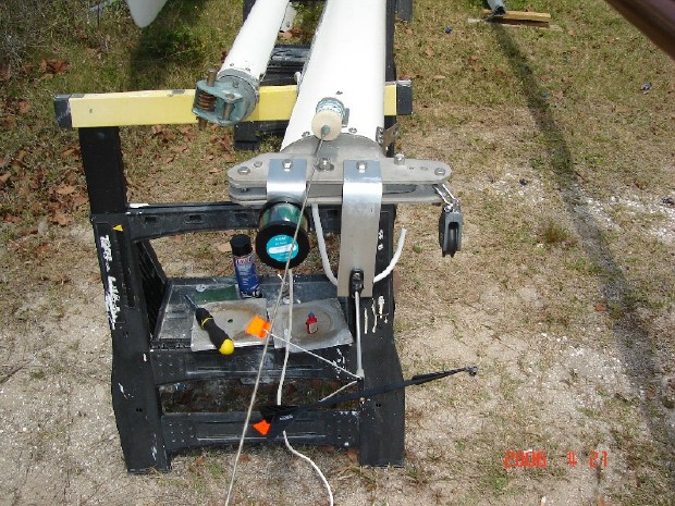

I'm thinking bolt on a sleeve over the damaged area. Sort of like the tricolor holder in this photo, but bigger.
I saved this picture, forget whose boat it is
Thanks for the picture. Looks like something I could do. Does this mean I'm out of luck trying to find a real replacement?
As with most other hardware for the mast, suppliers are no longer around. It's custom time . . .
Thanks for the bad news. I was kinda prepared for it anyway. The aluminum sandwich looks like a good solution. Or, there's an abandoned Commander at a marina at the other end of the lake that might not need theirs anymore. If it was to mysteriously disappear...
You might also try the folks parting out C-035 on ebay. Pat's email is amreja@att.net. Their ebay-based company is big lake boat parts http://stores.ebay.com/BIG-LAKE-BOAT-PARTS. That part might be old/deteriorated, but it might be worth a shot and spare the custom option for a couple years.
I'm lucky enough to have a foundry nearby that is in the business of recreating parts from broken originals.. Mystic River Foundry has done work for IYRS and other folks who need one-off's castings. There may be a similar shop near you. If you can remove the old part from the mast and epoxy it back together it can be used as a plug in a sand mold.
You might want to google for foundrys in your area that do architectural or sculptural work in aluminum...

You do hear of these old fittings getting 'crystalized'. But that's hearsay and I'm not sure that I've seen actual proof of this unless there is plenty of corrosion supporting it. The fitting on 338's mast was pretty ugly and pitted. Patching to an old casting might not be all that succesful.
Little Gull had a new crane mast top fabricated by Ballenger Spar Systems of Watsonville CA. Buzz would have the pattern still at hand. It would be a semi custom job so you could also get exactly what you desire. They made a pretty exact welded copy of the original for 338. The spinaker bail is an added loop of stainless rod.
