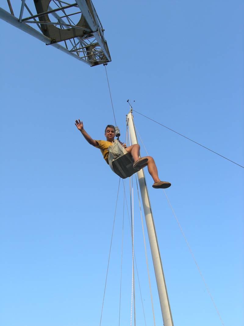

Everything went well. As you said, there is plenty space up there and the splice went through it nicely. The main sheave was actually so hard to turn, I wonder if the halyard was just sliding over it. After lubricating it, raising the main is much easier than before.
Awesome picture!! I would have been chanting "I trust my crane operator. I trust my crane operator..."
My dear crane operator was sipping beers and complaining I wasn't fast enough. In hindsight I must say I was more than a little lucky...
