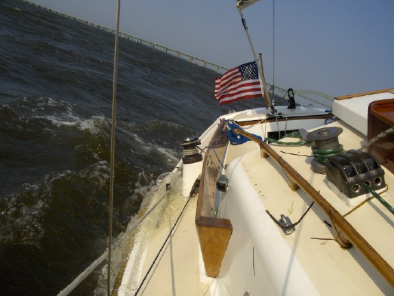

My track is on the deck. The area between the track and the toerail tends to get dirty, despite my efforts
