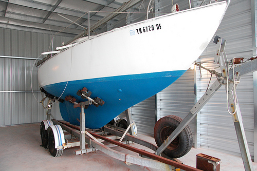

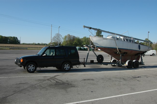

Just got the boat from my brother. I'm glad land rover's came with a 12 cylinder twin turbo diesel in 2000. What a load! My plan is to get this boat in a sailing condition soon. Anyone got any free time come on over, I'm in North alabama.
Hey Mike.
Congrats and welcome aboard
Man, I will never get tired of seeing pictures of these beautiful hulls. :D
(that is saying something, I have had 'Faith' on the hard, doing hard labor for 2 weeks now.. )
Getting a trailer with it is a real bonus, good luck on getting her ready, and back in the water.

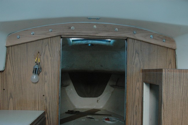

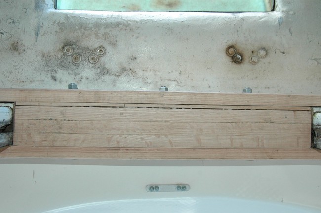

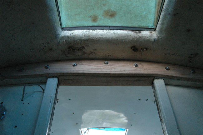

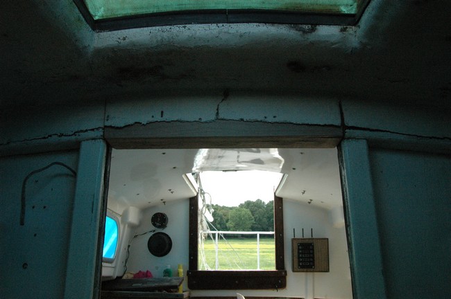

Here's some pics of the bulkhead repair under the mast.
Yes Mike, welcome a board!
That strongback does look strong.
I would sit back in there and check out whether there should be thru bolts thru the compression uprights in the corners of the doorway. That would lock those babies in.
Original Ariels also have cross bracing on that bulkhead that spreads the load outward on the V-berth seats.
However on the cabin side the beam looks well supported using the bulkhead.
Keep an eye on it, and maybe add back that extra bracing on the V-berth side of the wall sometime. This is imho.:D
Of course if the bulkhead was rebuild and everything is now epoxied together......
it's hard to tell sitting here in California!
Thanks for the advice ebb. I have a few extra bolts, I might as well add those there for some extra support.

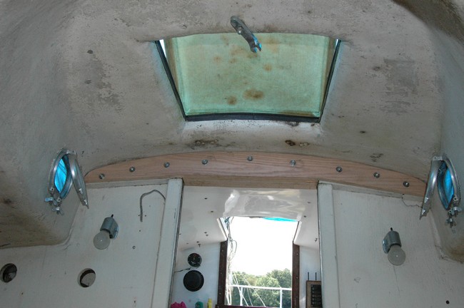

Here's a pic of the mast mount. I made the new base out of delrin.

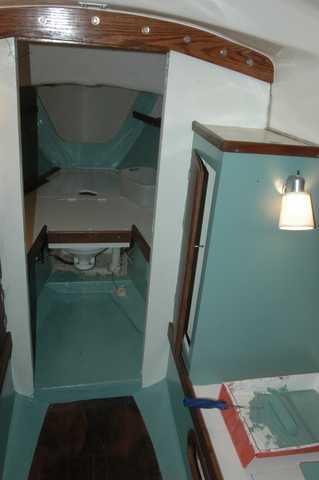

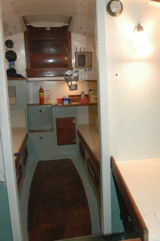

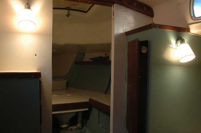

Here's some pics of the inside of my boat. I hope to have this boat in the water soon.
Thanks for the pics - looks like you've been busy! Good luck getting her ready to launch.
I painted the bottom this last weekend. I used Bottomkote by West marine.

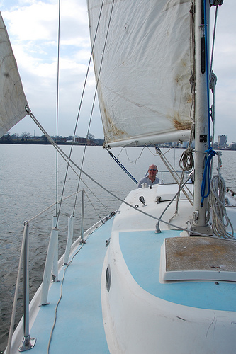

I launched the Ariel yesterday on the Tennessee River. Here's a few pics.
I still have some work to do, but I'm sailing between work now.
I have some stains on the main sail, any ides on how to remove stains??
Here are the cleaning instructions a sail maker gave me:
Lay out a big poly tarp on level ground - spread your sail out on the tarp. With a grease free, medium plastic bristle brush and 5 gal. pale with a solution of dish soap (joy) and liquid bleach (edit: not sure how much bleach) - give each side of your sails a vigorous scrub - rinse clean and hang on a line to dry. Be sure the sails are completely dry before flaking and storing.
Don't know if it'll work on stains, but I suspect the bleach would certainly help. (Ebb or someone else may know of some natural and friendlier cleaner to use instead of bleach - maybe he'll pipe in?)
