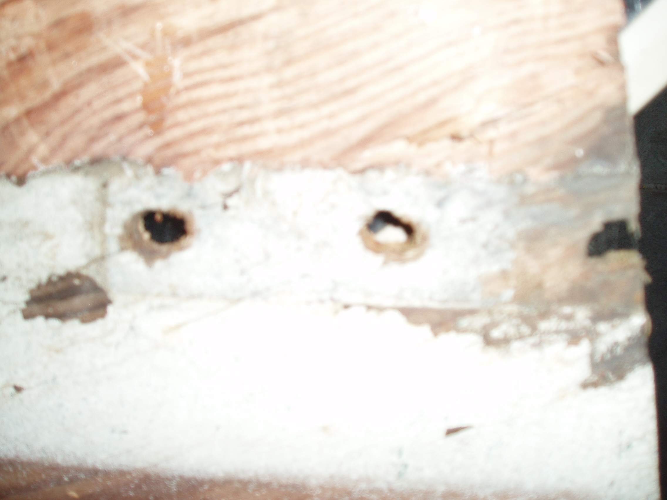

Take a look at this boom end fitting for the mainsheet - the bolt is getting a might on the thin side. I don't think the fitting is really meant to have the figure eight shape either. What is a little unusual is that the stainless bolt has taken as much punisment as that cast AL fitting - I would think the bolts threads would just saw away at AL.
Some more egging out - this is the rear port chainplate knee - appearently the chainplate bolt's threads egged out the plywood in the knee until the first bolt met the underside of the deck. Probably not a failure waiting to happen as the boom end fitting but would not make a happy boat.
A personal peeve is not matching a bolts shoulder - the smooth part - to its use - if threads contact either plywood or metal it will result in a sawing action and egging of the hole.

I removed this fitting on 'Faith' about a year ago, and found similar damage.
What caused me to remove it was that the stainless tang that the mainsheet attached to was really loose. I found that the bolt was necked down, and that the nut had come apart inside the boom, leaving only the distorted plastic washer inside that had fused it's self to the threads~!
