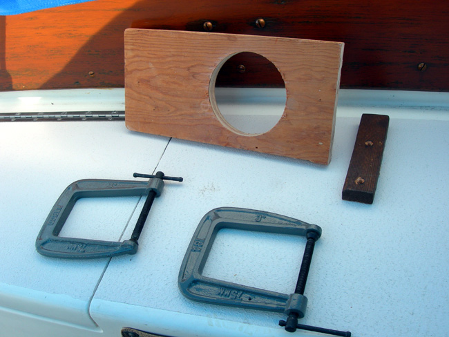

Ebb Borregaard to the rescue! After listening to my tail of woe, Ebb Borregaard suggested that I use the saw to cut a hole in a piece of scrap lumber and then place that piece of wood over the old hole to use as a saw guide.
Eureka! What a great idea. How come I didn’t think of that?

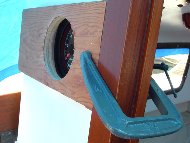

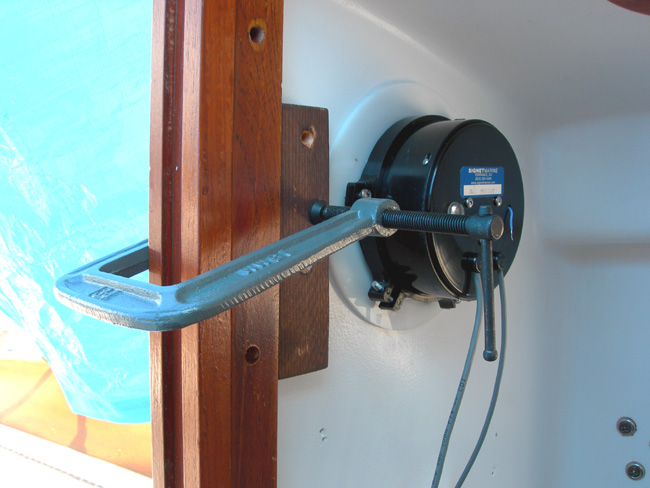

Using the 4-1/2 inch diameter saw, I cut a hole in a scrap of plywood. Next, I purchased two 3-1/2 inch wide "C" clamps with as deep a reach as I could find (that turned out to be 4-1/2 inches).
Here is the "custom hole drilling assembly:"

So you have this scrap with the pilot hole already drilled. Instead of clamping it on the inside, clamp it on the outside like Bill shows. The 1/4" hole would be easy to center in the old hole with light coming thru it. In fact, as Bill shows, you can take the scrap and place it tight against the companionway trim, goes a long way to keep it unmovable.
Even better, what you could do is place the scrap where it will clamp most securely (as Bill has shown) and with a flash light and a pencil trace the hole you want to enlarge on the scrap from the inside.
Unclamp it, find the center, then drill the pilot hole with a normal bit, clamp it back in place, and holesaw away using the drillbit hole for the pilot bit.
When you cut the disk out of the scrap, stop and remove it from the holesaw.
Then proceed to cut the fiberglass using the hole in the scrap as the guide. You can make minor adjustments of your template befor you cut.
