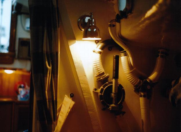

As for the waste holding tank, I have a small 'bladder' like a bag that fits into the area next to the head (toilet). Since it is a bag, it fits into the shape of that space well.
It is attached to a hose leading to a valve, that allows me to either pump the waste into the holding tank (bladder/bag) or over the side.
I know there is one person here (liz?) who converted the water tank under the v-berth to a waste holding tank. I would not do that, as I prefer to carry drinking water to carrying waste!
