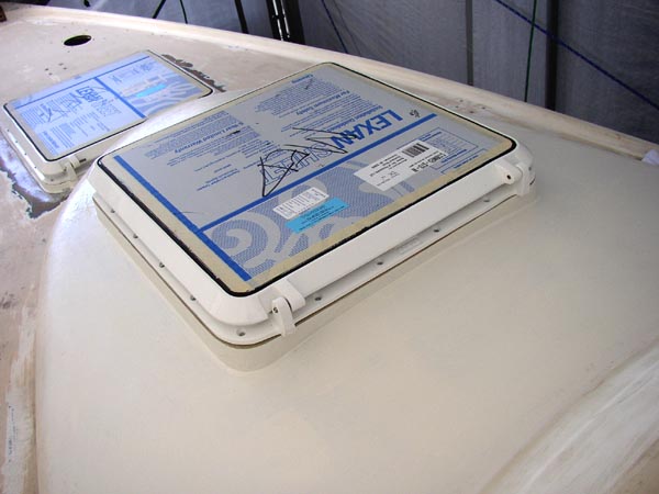

I glassed over the hole for the forward vent and installed a SS solar mushroom vent in the forward hatch. Works great and no tripping , fouling or water intrusion.
in hatch shroom vents
Mike, you are a man of few words and your advice while short and to the point is most persuasive. 338 happens to have a foredeck hatch now, and a ss solar Nicro in the center of the lens both forward Bomar hatches will make a very tidy and airy install. Thanks!
For finishing the inside of the hatch Nicro makes what is advertised as a soft vinyl trim ring for what of the vent that projects below right over the V-berth porto potti in Ariels. Instead of bang in the middle of the hatch, is it possible to place the vent off center? :D
A cruiser pointed out that the optional ss shell extends the life of the ABS vent. Haven't seen any Nicro claims that their plastic has UV protection. ABS gets brittle in the sun.

Do you really want to cut 4-5" holes in your brand new hatches?
Oh buoy! Yeah, who wants to put holes in those expensive babies!
Mushroom vents don't keep water out with direct hits either. But they can be removed if so mounted and a plate snapped in. Don't sound strong - if you can 'snap' a plate in then obviously you snap the vent out. (?) So could a dexterious dollop of briney, wouldn't you say?
What bothers me about the solar vent is that it is a patented device, stuff can go wrong. A cowl vent could just as easy be UNSCREWED and a plate turned in. A non electric dorade box is probably the most versitile water resistant vent but it needs to be fairly large for efficiency and is rather awkward. They need to be designed well to get air in. There are pvc vents of many descriptions, but they mostly look hokey and vunerable.
Hatches can be left open in a "vent mode" but also can let in water. While sailing our forward opening hatches would have to be down. Ventilation below while sailing and sleeping is absolutely primary. I wonder if the Nicro solars actually let in enough air? Rather have too much and figure out how to turn it down. The original forward hatch on 338 could be left open an inch or so and remained dry.
Air movement is very important to me, and it's a puzzle how to introduce more on the Ariel because of its size and paucity of options. That's why using the hatch, itself a vent for double duty seems like a good idea. But choosing a gizmo that can stop working is not smart.
