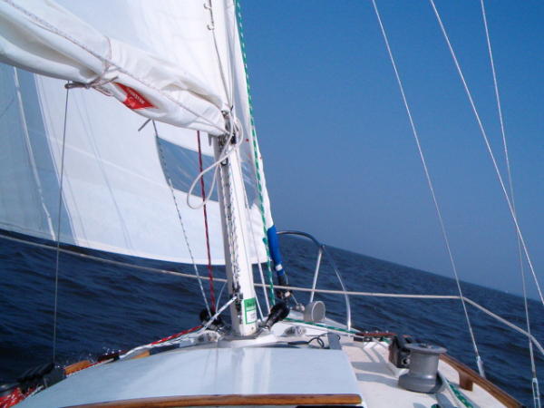

Like this?
http://pearsonariel.org/discussion/a...tid=1792&stc=1
This is from Commander P's gallery. I was checking for some glamour shots of "Grace" which are woefully absent, I might add. Especially considering his newly painted mast. Got that Cmdr Pete? Let's see pictures! (Of your boat, that is...)

Found a picture.
