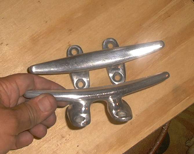

Having re-thought my Deck Hardware Plan [size=1]< Click [/size]
[size=2]I have decided that the [/size]'hershoff' style cleats I purchased for the jib sheets are not as well suited to working line as were the originals.
I am still going with the Hershoff's I have mounted aft, as I like them for static line. Rather then shop for stainless horned cleats, I decided to polish up the original cleats. Polishing the plated stuff (such as the tiller head) may not work, but the marlon seems to shine up ok.
Here is what I got;
Yeah - my cleats look ok but I really did a number on the tiller head trying to clean it up. SPO got varnish all over it and SCO tried to get it off and ended up taking the plating down to the bronze.
