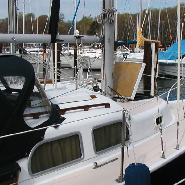

This is for French,got your e mail is this what your asking about?
Yes it is. It also looks completly different from mine. After looking at several other pictures closely they mostly have a different set up. I guess I'll just put mine together by logic and see how it comes out. I 'll post a couple of pictures for advise. thanks

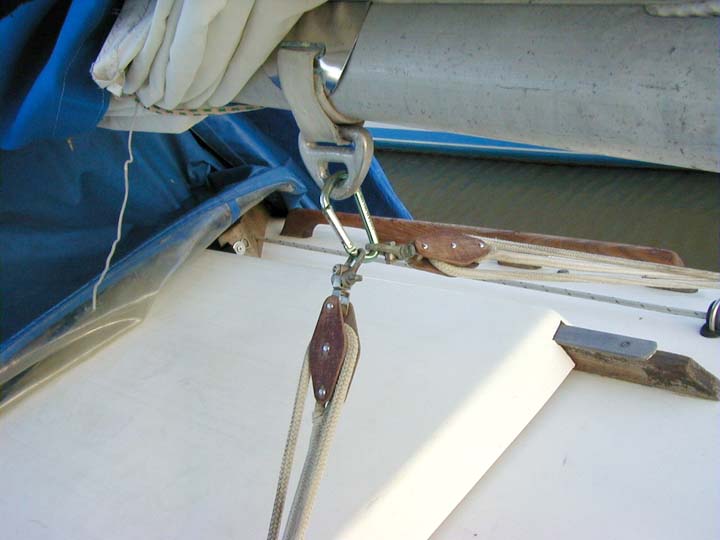

This is my hookup for the Boom. Anyone have something like this, and see something missing??
Your set up looks like a combo boom vang/boom brake.A boom vang attaches at the base of the mast only.How do the outboard ends attach?Maybe its some fancy California rig?Capt. Bill might know.Only thing close to your set up that Ive seen is a boom brake.
Hmmm Boom Brake sounds right. This setup has another pulley further down , then ends up in a crab cleat.
It seems like all it does is stops the boom from swinging.
Just to hazard a guess.... I think it looks to be a preventer set up for both port and starboard tacks. Saves changing over the rigging from side to side.
Jibe Ho !!
How is the stainless band attached to the boom? Screws/rivets or maybe the boom is different than mine and the band can just wrap around the boom and be cinched down with the nylon strap.
The band slides over and hooks into the sail track, tight fit, the nylon is not adjustable, so I guess the pull of rigging gives it the extra tension...
"Preventor", that is what I heard it called by someone I spoke with at the maintenance meeting. I was not sure if that was what she was referring to, but the discripion sounded like it.
French ,a boom brake and a preventer are the same thing.,I can cleat off my vang on either side to make it a preventer.
Hooks into the sail track huh? So is the band a two piece affair or do you have to load it into the sail track as you would to attach the sail by sliding it into the track??
I like the idea of spreading out the load by using a wide band like that. A hard jibe can develop a horrendous load on the rigging.
The way yours is set up, it would seem you get a couple of benefits - not only a preventer but also the effects of a boom vang and a way to control the swing of the boom as you knock back a cool one whilst becalmed in a gently rolling sea. The sun beating down ...... Geez I wish the fog and rain and fridgid air would disappear....

It is a two piece unit. Outside bands have a lip that hooks to the inside of the sail track.
Quote:
