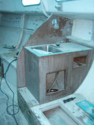

The boat has six partial bulkheads (where the chainplates are attached) that are fiberglassed to the hull and the shelves. One or two of mine had detached or develped a crack in the fiberglass at the attachment point. I'm in the process of re-attaching them (re-tabbing them I think its called)
First I sanded down the layers of old paint to get to the fiberglass. Even this was not easy. I went from 80 grit, to 60, to 36 then used a wire wheel. I ground off any suspect fiberglass.
The plan is to apply overlapping layers of fiberglass tape over the original fiberglass with epoxy.

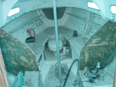

Here is the scene part way through the destruction process. I'll get some better photos this weekend.
