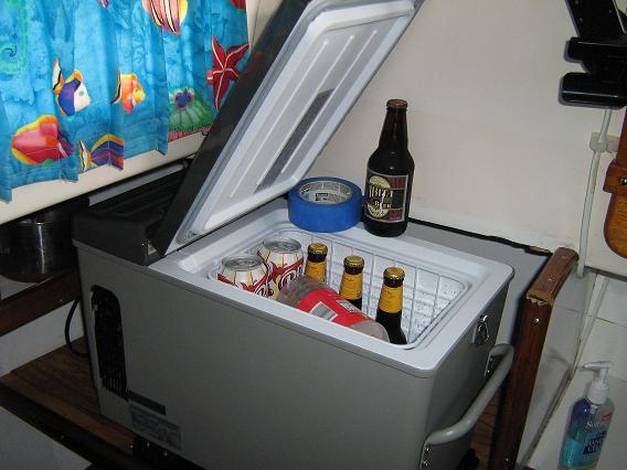

I looked at a few models of the Engle,
The Engle 15, 14 Quart
http://www.compactappliance.com/imag...FD015DA_dt.jpg
• Outside dimensions: 14.5"H x 11"W x 17"L
• Inside dimensions: 13.75"H x 7.5"W x 7.5"L
This would have fit best onboard, and the storage space would probably have been adequate for my needs. The issue with it (for me) is that is has a slightly higher advertised current use then the larger models (probably due to less insulation).
Then is was the 16q, or the 22q. They both have the same advertised current use… .7 to 2.5a
• Model: MT17FU1
• Fits 24 cans (12 Fl.oz) Dimensions: 14.2"h x 21.1"w x 12"d
http://www.compactappliance.com/imag...MT17FU1_dt.jpg
Then it was the 22q model, (model 27)
http://www.compactappliance.com/imag...MT27FU1_dt.jpg
Power Consumption: 0.6 - 2.3 Amps
Fits 30 cans (12 Fl.oz • Dimensions: 21"h x 12"w x 18.2"d
From there you go to the 34 and 43 quart models.
I like them for their capacity, but they would not fit on my boat without some modification.
Model: MT35FU1
Volume: 34 qt. / equivalent to 54 12oz. cans
• Outside dimensions: 16"H x 14 1/3"W x 25 1/2"L
• Inside dimensions: 15.4"H x 10.8"W x 12.4"L
0.7 Amps in refrigeration mode; 2.5 Amps in freezer mode
Weight: 46.3 pounds
Model: MT45FU1
Volume: 43 qt. / equivalent to 60 12oz. Cans
• Outside dimensions: 20"h x 14 1/3"w x 25 1/2"l
• Inside Dimensions: L 15.4" x W 10.8" x H 16.4"
Weight: 52.9 pounds

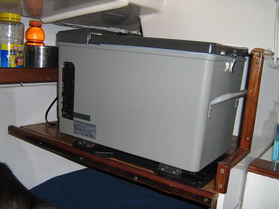

I took the measurements out to my boat, and figured out that the model 27 was the right one for me.
I like the model 43, but the 25” length gets me. I would have to stow it lengthwise in my v-berth, or rebuild my interior to accommodate it. This would take up too much space, and the lid would not open more then ½ way.
The 18.5" Model 27 should sit at the aft end of my V-berth (on the port side) and the way the lid opens from the end should make it a perfect fit.
