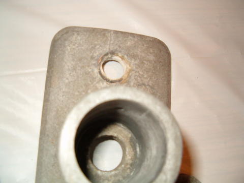

I cannot find the newsletter with the drawing of this casting. Can someone please fax it to me at (718) 797-1983?
RigRite has several different ones that may fit/have been used by Pearson. My commander hull is #92. If someone that has confirmed bolt hole dimensions on a boat close to mine and would be kind enough to let me know, I would appreciate it.
(It seems the yard moved La Saladita, Commander #92, and upon raising her with the crane she leaned forward and the port spreader socket disentegrated. Foreman said there was nothing that hit it, but I wonder. There was a lot of freezing and thawing this winter, and these castings are 38 years old. Time to replace both sockets, and maybe all the standing rigging.
At least I will have to have the mast down and take the stays to a rigger for a close inspection.
So, I followed a prior thread and found that RigRite carries these. Any other ideas? I have not located my Winter 2002 newsletter which is supposed to have a drawing of this casting, but I'll keep looking.
Regards to all,
David)

a number of tritons have lost spreader bases recently, it seems that the castings just sort of give it up eventually. james baldwin just lost one on a triton he was delivering for someone else, i understand.
probably best to replace these. tips, too...although i've never heard of it happening yet, i have seen a lot of chalky corrosion on old aluminum tips where the shrouds contact, and worry what would happen if the tip turned to cookie crumbs. losing the tip, base or tube hard on the wind in 20 kt. or better does not appeal to me as the results cannot be expected to differ from parting a capshroud.
FWIW, i'm replacing the bases, tubes and tips on our triton, and am looking into machining the bases and tips from billet stock.
best,
dave

So, the other source for these (that Jay Maloney uses) is D and R Marine. I have ordered two (2) from Rudy over there. Jay did not really need to broker this deal, so he was kind enough to just give me his source. He has had a hard time working with RigRite, and since their price is so high, I wonder if I will ever try again.
They do have some gooseneck parts that I need, but that will be another thread.
