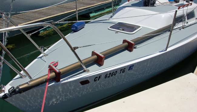

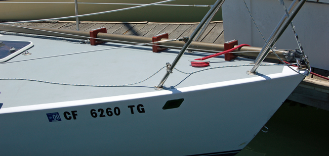

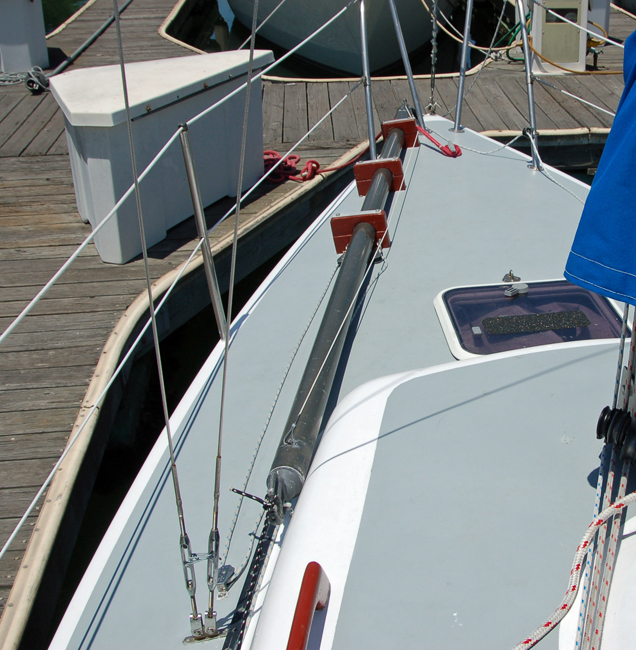

Here's some interesting hardware at our dock -- a movable bowsprit that appears to be removable. Why go to all the work Ebb is contemplating, when you can easily add this bit of sail handling hardware. One carbon fiber tube and three clamping fixtures is all it takes . . .
