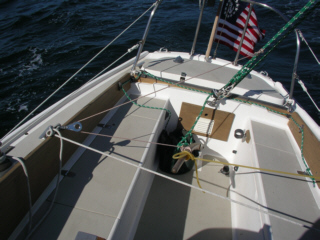

In the attached photo is my first attempt at a sheet to tiller rig for close-hauled sailing. I have not yet cut any lines or surgical tubing, so I had to tie a few temporary knots and make some adjustments as I went. (Ever tie a bowline or a half hitch in surgical tubing?). Nonetheless this crude system worked great while beating in variable wind and swell in the ocean today with working jib and full main.
I am most interested if anyone else out there has experimented successfully with sheet to tiller arrangements and I am especially interested in photos and specs for sheet to tiller self-steering rigs for all points of sail on an Ariel.

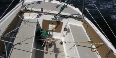

I am still messing around with sheet-to-tiller steering for my Ariel. I am having considerable sucess (as in sailing close hauled for miles in modest open ocean swell with winds to twenty plus mph)
The photo below is my mainsheet tension-driven gear, which is proving very effective for close-hauled sailing to almost a beam reach. That system has moved from prototype to fully functionally system in final form with its teak tiller-mounted steering control box. This box is also used with the jib sheet-to-tiller gear. The system also features a weather-side vang, and lee side (one, two, or three strand) surgical tubing elastic. Don't use bungee. Use surgical tubing. This tubing is 3/8 inch OD (outside diameter). Note: Medical supply folks sell their surgical tubing by inside diameter, but sailors describe it by outside diameter.

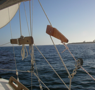

The next photo is my prototype jib sheet cam lever designed to transfer a partial load from the jib sheet onto a line run through three blocks to the tiller. It is hard to tell what is going on in this photo because with this prototype the cam lever, when engaged, is too close to horizontal to make the mechanics of the design evident, but the cam lever does seem to work at least to some degree. This is an intentional, if poorly executed, rip-off of the cam lever design on the wonderful sheet-to-tiller steering page:

What I can't do is relax the jib sheet without the full load of the jib being transferred through the cam to the tiller. The red line in the photo is the tiller steering control line. The line to which the clip is attached is the jib sheet.
The chief issue is that is you don't want to let out the jib before you disengage the cam cleat on the side of the tiller steering control box. So you need to release the steering control line first, or perhaps disengage it completely at the tiller mounted steering control box until the jib has been reset, and then re-engage it afterwards. This jib sheet cam lever should work for broad reaching or a beam reach.
I need to make refinements here. I would prefer a horizontal cam lever on the lee side of the cockpit that would be accessible from the cockpit. On a day like yesterday, (20+ mph winds and lumpy) going forward on the lee side while alone to engage this cam thing is a real hassle. I did not even try to engage the cam lever until an east wind picked up close to shore, banishign the prevaling westerlyt, and then (as shown in the photo) I was able to play with the cam lever in that five knot easterly. Santa Cruz Point is in the background of the photo.
The cam lever is a prototype made of scrap redwood that I had in my shop. If it works, I intend to remanufacture the cam lever in teak.

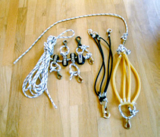

So, once you have made up your surgical tubing piece and purchased your blocks, you can use them all on both the main-to-tiller and jib-to-tiller gears. You need surgical tubing, Dacron line, some blocs, some snaps, and two cam cleats or another ay of attaching lines to your tiller. You also need some mechanism (cam lever or vang system) for transferring part of the jib sheet pressure to your tiller for the jib-to-tiller gear. The cam lever can be built of wood and fasteners like my prototype, or of wood, two sheaves and half a cam cleat as John Letcher recommends.
All authors seem to recommend surgical tubing becasue of the linear stretch curve of that tubing over the parabolic stretch curve of bungee cord. However surgical tubing is easily damaged by UV light. Some authors recommend colored surgical tubing as more light resistant

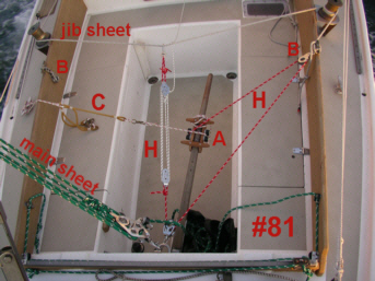

In the jibsheet-to-tiller gear, appearing in the photo below, the jib sheet is lead around the leeward jibsheet winch and then wrapped around the weather side winch and secured to a cleat. See photo #67. One end of a four part tackle (vang "H") is secured by a snap hook to the midpoint (between the winches) of the jib sheet. The other end of the control line attached to vang "H" is run through a series 25 block "G" attached to a pad eye in the center of the rear cockpit bulkhead (where the mainsheet is also attached in this photo). The control line runs from the end of vang "H" through that block and up to a weather side series 25 block "B" on the coaming board and then to steering control box "A" on the tiller.
The system uses tension from the jib sheet to control the tiller, but collects that tension from the transverse section of the jibsheet between the two winches. The tiller senses the tension and makes adjustments accordingly. A counter force is applied by the elastic device "C" at the left side of the photo on the lee rail.

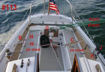

Once you have seen photo #81 above, this second photo #113 will be easier to understand. Photo #113 shows an improved jibsheet-to-tiller gear that reduces friction in the gear as pictured in photo #81. In photo #81, the gear uses the leeward jibsheet as a fairlead (the jibsheet makes a one quarter turn around the barrel of the leeward winch).
In photo #113, a device identified as "J" slips over the leeward winch. This device positions a block correctly to run the jibsheet across the cockpit to the windward winch. Subsitituting that block for the winch-as-fairlead makes this gear much more responsive and removes overcorrection due to friction in the gear as pictured in #81. Otherwise the two gears are identical.
During my first test sail using this device, I was free to go forward for extended periods while sailing on a broad reach for the first time in my singlehanded sailing career. The boat sailed a steady course on both port and starboard tacks while I took photos. Unfortunately I was so mesmerized by watching the gear work that I kept sailing away on a long broad reach until dusk when the wind totally quit blowing, at which time I decided to drag out the oars.
