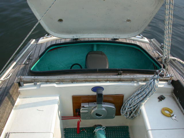

Egad, I know this subject has been beaten to death, but I did say I would report on the installation of this motor into my Ariel this spring. Being the same outside as the 8hp, it fit perfectly into the hull.

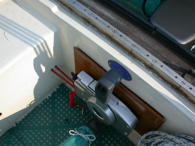

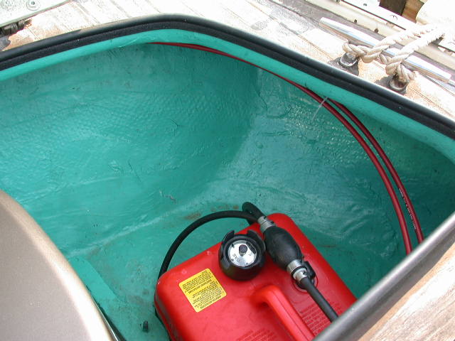

As for the remote control, I mounted it in the removable bright mahogany panel in the after bulkhead just over the tiller shaft. So it sits athwartships just under the nameplate and the cables zip into the starboard locker, through the after bulkhead, circle the lazarette under the deck and hook up to the motor(thirteen feet). The Nissan is a generous and sturdy remote, but it fits and works perfectly there and is out of harms way.

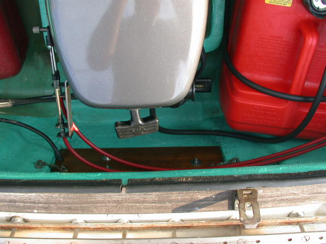

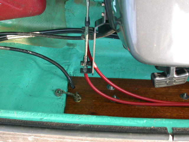

Wiring up was a breeze and for the main power cables to the battery under the companionway, I spliced in a nice "tangleproof" twin type jumper cable with the ends cut off and modified. The idle exhaust port was fitted with a copper tube fitting which connects to a transom through hull.
Top speed is equal to or better that the 15hp Evinrude it replaced, and it is much lighter and quieter. Probably the 8hp would be satisfactory in most cases.
Overall, a great and happy repower.

remote control mounting
you must send pictures. i have a remote control and cannot find a good place to put it.
also, do you leave it in the well all the time, or take it out after a sail?
my merc 9.9 seems too heavy to not leave in almost all the time, and even when i do take it out, i get tangled in all the control cables and wiring.

Capt. Mrg.,
Just as soon as it stops raining (!) here in Jersey I will pop out the ol' digital and post you some pix.
I used to remove the 15hp Merc after sailing( lots of Bar-ne-clees here in Jersey). But the new Nissan has too much schmugabooda (cables, wires, clips, brackets-you know) to permit such hauling. So over the winter I carefully applied the special primer/top coat aluminum lower unit anti fouling humbug paint and I'm keeping it wet and hoping for the best.

Remote control mounting
Capt. mrg,
Here are the pix of my Nissan remote mounting on the trusty Adele M..
Ah, Dan? The pictures lack resolution . . .

The next series of photos will trace the travel of the remote control wires.
