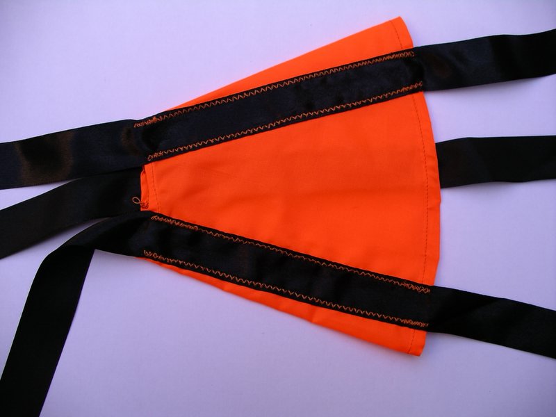

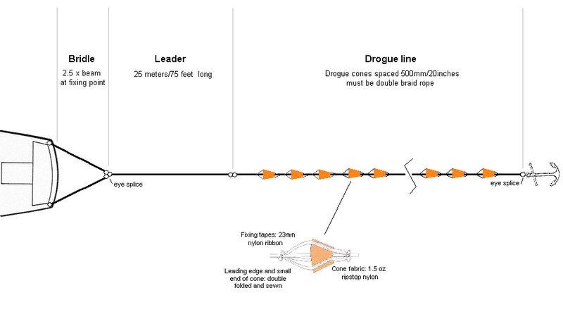

“This paper documents the investigation of the use of drogues/sea anchors to prevent small sailing yacht capsize in breaking seas. The following conclusions were reached:
i) _____In many and possibly most cases, a properly engineered drogue can prevent breaking wave capsizing.
ii)___._ For fin keel sailing yachts the drogue/sea anchor should be deployed from the stern, not the bow.
iii) ____A series type drogue provides significant advantages over a cone or parachute type drogue/sea anchor.
iv) ____A full-scale series drogue demonstrated satisfactory handling and durability characteristics under simulated storm conditions and in actual breaking wave conditions.
v) ___._A recommended design specification including design loads is presented for cone, parachute and series type drogues”.
U.S. Coast Guard Report CG-D-2087 sec 7-0
Series Drogues and boat design
“With a series drogue deployed, a well-designed and properly constructed fibreglass boat should be capable of riding through a Fastnet type storm with no structural damage. Model tests indicate that the loads on the hull and rigging in a breaking wave strike should not be excessive.
Many sailors are reluctant to deploy a drogue from the stern because they fear that the boat may suffer structural damage if the breaking wave strikes the flat transom, the cockpit and the companionway doors. The model tests do not show this to be a serious problem. The boat is accelerated up to wave speed and the velocity of the breaking crest is not high relative to the boat. The stern is actually more buoyant than the bow, and will rise with the wave. However, the boat may be swept from the stern. The cockpit may fill and moving water may strike the companionway doors. The structural strength of the transom, the cockpit floor and seat, and the companionway doors should be checked at a loading corresponding to a water jet velocity of approximately 15 ft./sec.
When a boat is riding to a series drogue no action is required of the crew. The cockpit may not be habitable and the crew should remain in the cabin with the companionway closed. In a severe wave strike the linear and angular acceleration of the boat may be high. Safety straps designed for a load of at least 4g should be provided for crew restraint. All heavy objects in the cabin should be firmly secured for negative accelerations and drawers and lockers should be provided with latches or ties which will not open even with significant distortion of the hull structure”.
U.S. Coast Guard Report CG-D-20-87 sec 6-4

One page recommends that chainplates be installed on the quarters instead of the usual cleats and chocks on deck because of once-in-a-lifetime loads that may be experienced. (Once read a cruiser recommending that the lines be led aft from the samson post to the stern.) This is, of course, for deploying a drogue off the stern. Persuasive arguements are presented for this position - to which may be added that it is definitely safer to deploy, adjust and retrieve the device from the cockpit.
Using a sailboat called the Winston Churchill the "Seriesdrogue" website chooses to depict the boat in thumbnails with the drouge streamed from the bow, without explanation.
I may have missed something, but it is inconsistences like this that one applies to the product.
The smallest drogue made by this company is rated for a vessel a little less than twice the displacement of an Ariel. I'm onboard with more is better, but need to know if some cones would have to be removed or something, to control the boat in a once-in-a-lifetime situation. I guess the ticket would be around $300, and I guess we'ld order from them. so there may be customs fees and shipping that would jack the price.

At the same time I was wondering if, instead of the ubiquitous where-the-hell-did-I-put-it bag that has to be extracted from the bottom of a locker, if the gear could already be attached to the pushpit in a dedicated cover. I imagine it would be a sunbrella package that would live permanently above the taffrail on the stern.
Out of the bag on top the eye at the end of the drogue would be exposed. For storm use, a weight would be attached. For everyday cruising the seriesdrogue would have a float attached. A tug on a trip line and it would be released from its velcroed bag.
Since the idea is to trail the drogue to save the ship, it popped into my brain (my girlfren sez I am Al Z. Heimers) that trailing a drogue might also save the blathering skipper. AND SLOW THE BOAT DOWN as you write.
Seems like there's good stuff to grab on to, instead of a knotted rope. Since the gear requires dedicated chainplates (persuaded by your advice) off the rear, rapid deployment and dual purposing to my way of thinking follows.
Since a drogue is a drogue maybe a few foot loops could be introduced into the line. Maybe double pass knotting would be mandated. Dual use could/might also perk the interest of coastal or freshwater or bay sailors. Even couples with kids. Remember, the USCG has already suggested a alternate use for the drogue.
